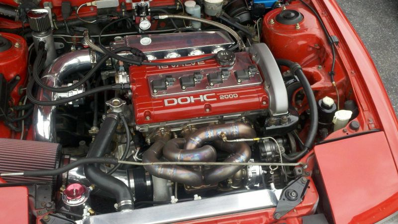

http://a7.sphotos.ak.fbcdn.net/hphot...13065608_n.jpg
Someone sent me a photo of my car from a meet last week.
Rolled past 255k miles 2 weeks ago.
I really need to rip the insulation off the firewall. It's all ripped up from a mouse (sat for 2 weeks waiting for a timing belt) and it's bugging me.
