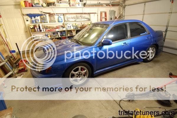

ok back to post the big update. decided to go 5x114 and lose out on the RGRs :(. this weekend i installed:
-STi R180 Rear Differential
-STi Rear Crossmember
-STi Aluminum Lateral Links
-STi Control Arms
-STi Front and Rear Axles
-STi Front and Rear 5x114.3 Hubs
-STi Front and Rear Brembos
-STi Silver BBS 17x8 Wheels
-STi Struts, RaceComp Engineering Springs, Group-N Tophats
-Perrin 22mm Rear Swaybar for STi
I had some very appreciated help here and there from Fred (WKDerf) and Anthony (auk113), and PoolMike swung by to check things out and so did Phil from 201 Motorsports, so thanks for the help guys.

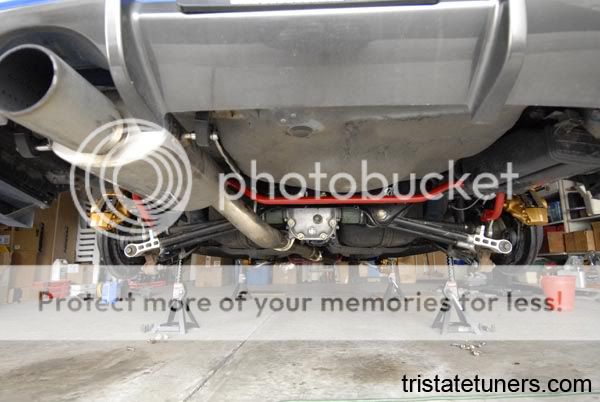

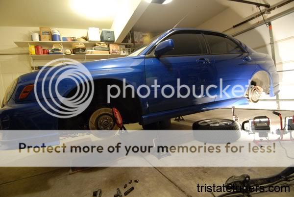

I did go at most of this solo though, and it was very time consuming. All in all things went well but it was just so involved that start to finish took 2 days for me to complete, plus bleeding the brakes the next morning. I took my time, had to figure a few things out along the way, and as you can see was working on jackstands with hand tools, so I'm happy with the job and confident that everything went back together as it should which is the most important thing.

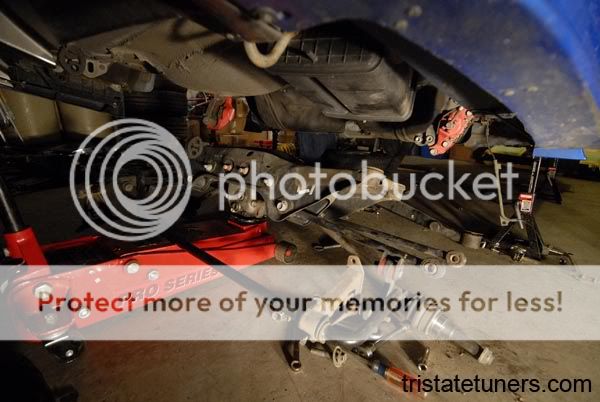

The rears were quite stubborn and took a while to get off. The lower strut bolts were rusted solid onto the hubs, the rear control arms were super tight, and that damn lateral link bolt was corroded to the links. Rough way to start an install but I got them off, eventually.

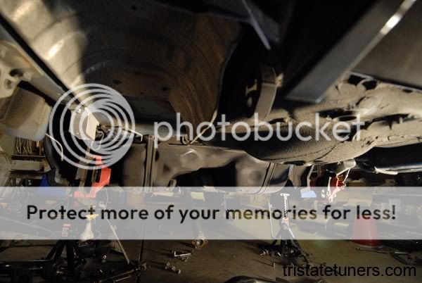

The rear diff wasn't that difficult to drop out after I got the hubs and coilovers out. A handful of bolts and the entire thing lowers as one piece.
The e-brake cables were the end of me. I spent the rest of the night trying to figure them out, and ended up calling it a night because I was exhausted.
Next morning after some reading and research I realized that the length of the ebrake cables changed slightly through the years. After some experimentation and a lot of dis- and re-assembly of the e-brake assemblies at the hubs, I was able to use my WRX e-brake cable with the STi rear end to make it work.

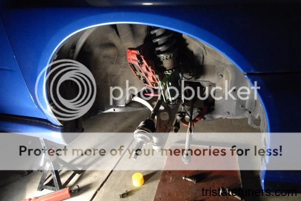

Front hubs were pretty quick getting off. Got that figured out, but it used up about half of my day. Wish I would have known about that problem, and that solution ahead of time.
Front axles and axle seals went in as planned. New hubs bolted on as planned.
Suspension went in as planned all around as well. Decided to try a more streetable but still just as capable setup to see if I like it... STi struts, RaceComp Springs, and Group-N Tophats. Less bling, but I'm over the wow factor of coilovers, I just want something that takes care of business and the components I chose this time around get very good reviews from auto-xers and serious suspension guys.
Bleeding 2 valves on each caliper is a bitch, but we got through it. The pedal feels pretty good but when I have a chance I'll bleed them again just to get it in tip top shape.

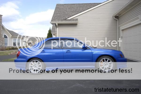

Thats about it... everything feels great, and the look is super clean. Looks a little too much like a stock STi to me right now, but I'm on the look out for some more interesting wheels so hopefully I'll find something I like.

before:
http://i324.photobucket.com/albums/k...p/_DSC2892.jpg
before:
http://i324.photobucket.com/albums/k...p/_DSC2896.jpg
stock rear hubs removed:
http://i324.photobucket.com/albums/k...p/_DSC2901.jpg
stock rear end being lowered out of the car:
http://i324.photobucket.com/albums/k...p/_DSC2902.jpg
emptyness:
http://i324.photobucket.com/albums/k...p/_DSC2904.jpg
front hub removed:
http://i324.photobucket.com/albums/k...p/_DSC2913.jpg
new rear diff, aluminum lateral links, axles, hubs, brembos, swaybar:
http://i324.photobucket.com/albums/k...p/_DSC2919.jpg
done and done:
http://i324.photobucket.com/albums/k...p/_DSC2940.jpg

The second looks much better than the first. Good work...im guessing the small wheels in the first pic are your winter wheels?
