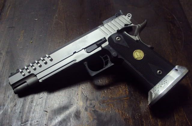

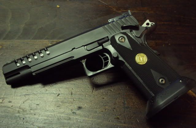

drifty240 12-20-2011 07:20 PM
Just got my 2011 back from EFR - Armour Black Cerakote
Before
http://i73.photobucket.com/albums/i2...Fusion6in1.jpg
After
http://i73.photobucket.com/albums/i2...efinished1.jpg

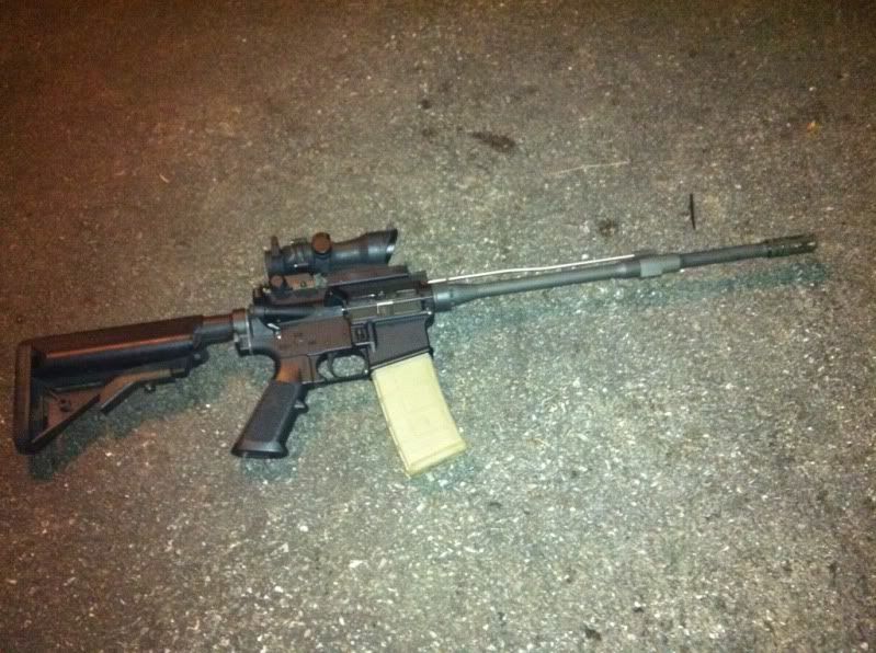

another pistol I love....
http://i73.photobucket.com/albums/i2.../arpistol1.jpg

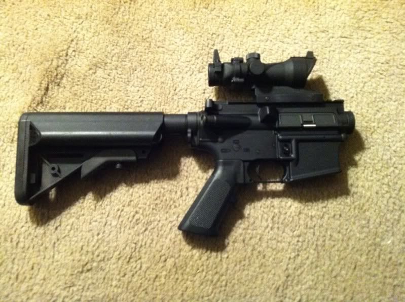

ar pistol win. i want a 10.5" one but i want my 16" middy done first. I just ordered a RRA Lightweight 16" mid stripped bbl, and gas block stuff yesterday. im goin with centurion arms 10" C4 rail.
http://i16.photobucket.com/albums/b3...3/3dd98b74.jpg
FACOG was $140. imma try it out. if its crap I'll just airsoft it. I'm gonna be 90% CMMG .22lr with this one so it should be fine.

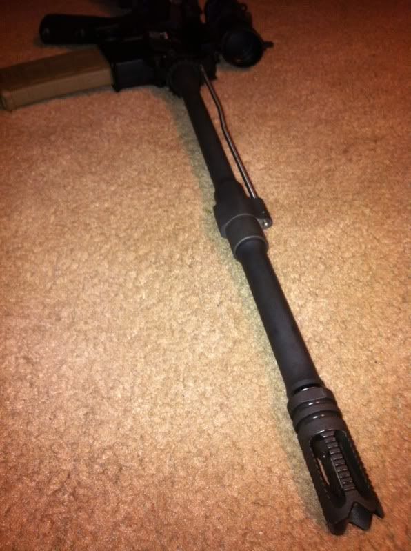

my barrel arrived today!
http://i16.photobucket.com/albums/b3...3/bb69864c.jpg
http://i16.photobucket.com/albums/b3...3/3c678a26.jpg
