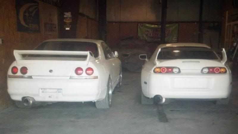

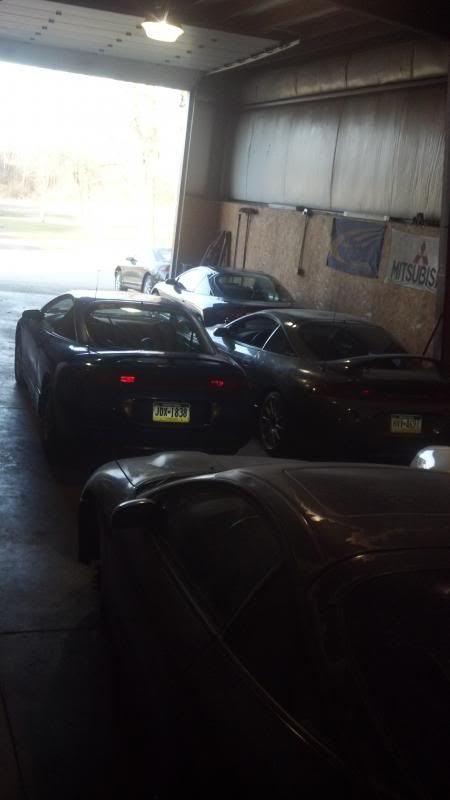

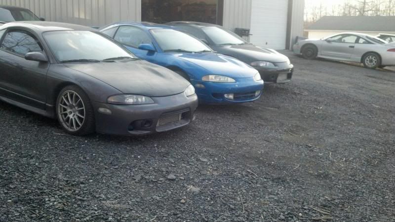

A few pics from yesterday, Trying to clear out my garage but every time one leaves more come. The 1g is the one getting crushed so if anyone needs anything let me know I'd hate to see someone pay for something online or from someone else if I have it and it would only be getting crushed anyways..
